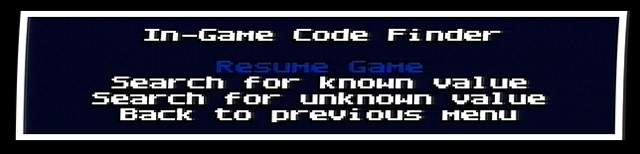

Code Generator
This is only available in the "Pro" (v3.0+) versions of the GS/AR line. The expansion pack is required to utilize it. The purpose of the Code Generator is to allow the user to hack new codes. The difficulty of this task can range from easy to psychotic, depending on a few things: the user's programming knowledge, user skill, good old fashioned luck, and the type of code being attempted. This discussed more in-depth later.

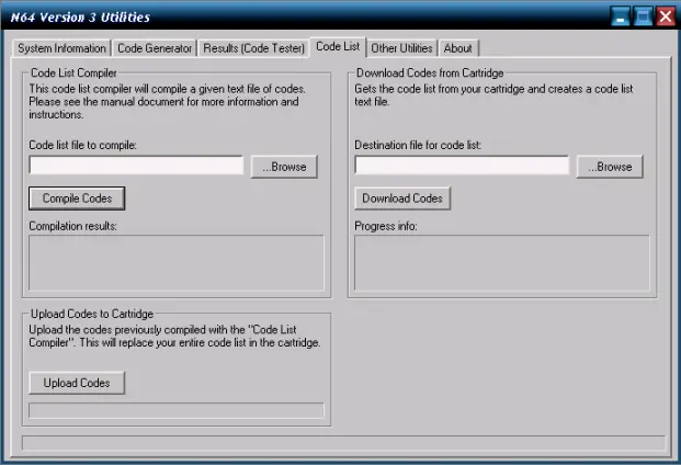

PC Connection and Utilities
GS/AR Pro versions 3.1 and higher have a DB25 connector on the back for linking up with a PC through the parallel (printer) port. A DB25 male to DB25 female cable (IEEE-1284 compliant) is required to do this, along with the N64 Version 3 Utilities released by Datel or Game Software Code Creator. With the console off, insert the GS/AR with a game a top, and hook up the cable. Boot the device with the DB25 cable connected (one end to the device, the other to the PC), and leave it at the main menu. Next, open the N64 Utils. Click the Detect button to see if everything is connected properly. If the device is not detected, there is a problem.
Troubleshooting
- Make sure the cable is plugged in firmly at both ends.
- Note that Windows XP has issues with Datel's utils program, but it's currently the only way to reflash these devices. There are some programs floating around that allow better parallel port access in WinXP. It might be worth a try to search for them.
- Another common issue is the parallel port settings in the PC's BIOS. To access these settings, look for a "Press X key to enter setup" type message when the PC is first turned on or refer to the user manual for the PC. Most systems usually use the DEL or F1 key. Once in the BIOS, locate the parallel port setting(s) and be sure it's set to EPP or ECP. Bi-Directional won't work.
After detecting the hardware to be sure it's connected properly, go to the Other Utilities tab, and click the Upgrade button. There is checkbox above that button with the option to overwrite the code list with the default (official) list or not. It will take a moment to send the upgraded software to the device.
The "Piggyback Reflash" was something discovered by someone that was just messing around, and it has given users a chance at reviving corrupted (unbootable) devices. This is like a defibrillator for GS/AR. Beware, however, it can be hazardous to the working device used in the procedure. The authors and device manufacturers are not liable for any damage caused to devices by attempting this.
A working GS/AR is required to do this. It is advisable to backup the code list before beginning. To begin, place a working device in the N64 and connect it to the PC with the DB25 cable. Then, put the defective device on top of the working one, and put the game on top of that. Now go to the Other Utilities in the N64 utils and click the Upgrade button just like normal. The result is BOTH devices being reflashed to that version! This has even been know to work for reflashing older (pre v3.1) hardware to v3.3. Of course, there's no DB25 port on the back of an old shark to hack with the PC programs, but the code generator and code type upgrades are nice.
If a working GS/AR with a port on the back is not available, but a GS/aR without an LPT is, it's worth a shot booting the good shark once with the fried one on top. Sometimes, it brings the dead one back to life.
Altered GS/AR Software
There can be altered versions of the GS/AR rom. The only one currently known is Perfect Trainer. It has some nice enhancements over the regular GS/AR. It's mostly geared toward hacking of high resolution games (like Perfect Dark) without crashing so much. It also supports a pointer code type. Flashing it is as simple as backing up ar3.enc in the N64 utils folder, and placing the altered rom there instead. Then flash as normal. It can be flashed back to the regular software, so don't worry about being stuck with anything. This will probably be mentioned in more detail later.
Grabbing Screenshots
The remaining item on the Other Utilities tab is pretty self-explanatory. Click the Grab Video Image button to get an image of what's currently on the screen (during a game).
Everything on the Code List tab is for use at the main menu of the GS/AR only. The code list on the device can be backed up by setting a file name (through browsing or just type it in) and clicking the Download Codes button. Editing a code list is as easy as opening a backup of it in a text editor. Just follow the basic syntax of file to add/remove codes and games. After editing is complete, the code list must be compiled before uploading to the device. Simply browse for the newly edited file in the Code List Compiler frame here, Then click the Compile Codes button. If the Compilation Results box lists errors, fix them and compile again. Once the list is compiled properly, all that's left is to hit the Upload Codes button and wait a moment for it to update the GS/AR.
Game Software Code Creator (GSCC)
Game Software Code Creator by Code Master (aka CMX) is much like the N64 Utils. It's primary function is hacking codes, but it has the ability to upload/download code lists as well. Getting GSCC connected to the GS/AR properly starts out the same as with the [[#PC Connection and Utilities|official utils] ]. One of the perks of GSCC though is better Windows XP/2000 support; however, communication still times out randomly on XP. It includes a special driver called Totalio. It seems to auto-detect the operating system being run on and activate totalio on its own, but if it doesn't there's a Totalio submenu located in the Debug menu with a Start/Stop option. The program must also be configured for N64 GS/AR. Below is a picture of the Configuration Menu (File > Configuration). The only part for beginners to worry about is the System + Communication Options frame. Notice the "Auto Detect Settings" button there. With a little luck, this will work. If not, try configuring manually like below. Note that GSCC cannot be used to upgrade/reflash the cheat device.
This is used basically the same as the one in the N64 Utils; however it compiles the list automatically before uploading. There are also edit boxes for viewing/editing the list within the program.

Hacking With GS/AR Pro
Turn on the code generator in the "Start Game Options" menu of a v3.0+ GS/AR (expansion pack required) before starting a game to enable the code creation functionality of the device. While in the game, you can press the GS/AR button at any time to bring up the in-game menu. It's laid out as follows:
- Codes Are (On/Off) - toggle codes on/off
- Code Generator
- Return To Game
- Exit To Main Menu
- Known Value Search
- Return To Game
- Exit To Main Menu
- Reset Code Generator
- Equal To (0-255)
- Unknown Value Search [before starting a search]
- Return To Game
- Exit To Main Menu
- Start (appears only before doing a search)
- Unknown Value Search [after starting a search]
- Return To Game
- Exit To Main Menu
- Greater Than Last
- Less Than Last
- Different To Last
- Equal To Last
- (8/16) Bit Search
- Memory Editor
- View GFX Memory (shows video memory, typically the last frame displayed)
- D-Pad and Control Stick scroll around.
- C buttons scale the image.
- L/R buttons change resolution.
- A button restores normal size/resolution.
- Start exits.
- Return To Game
Code Generator
For those who have hacked before, this about the same as any other trainer. If hacking a value that's shown on screen, try Known Value Search. If it's a health bar or something, you'd use Unknown Value. Alright, here's the classic "health bar" example. With the health bar on the screen, press the GS button. Enter the code generator, and select Unknown Value Search. Move on down the menu and select "Start." Now return to the game, and lose some health. Press the GS button again and bring up the unknown value search menu again. This time, there's some new search options. Obviously, since health decreased, the one to choose is Less Than Last. After this, the View Results item is added to the menu. If there are a lot (and there probably are), repeat the losing health - Less Than Last combination to narrow it down. Occasionally just walking around without losing health and searching Equal To Last is a good way to drop some junk possibilities. Once the results are narrowed down (hopefully 30 or less), go into the view results menu.
The box on the left lists first 100 results found. The box on the right shows active codes, but only the ones from searching. Codes that were activated from the main GS menu before booting won't be listed here. The data displayed here is similar to actual codes, but is just a list of addresses and values. Notice the values aren't padded and the prefix is not 81 for 16-bit codes.
Controls:
- Results List
- D-Pad navigates the lists.
- A button activates selected code.
- Start returns to the game.
- B button exits back to the search menu.
- C-Up opens the Memory Editor (but not to the selected address)
- Z toggles hex/decimal. V3.2 had a bug/feature; after switching to hex view, input for the Equal To search was also in hex. This was fixed in V3.3.

Official Hack Utilities
This is a fairly simple, but effective, trainer that can be used while the GS/AR is connected to the PC. It should be noted that neither the trainer nor the in-game code generator can search in hi-res (0x80400000-0x807FFFFF) region. There is a patch that can allow it though. There are a few differences in this compared to the in-game code generator...
- The option to enter search values in hex.
- Known and Unknown value searches aren't seperated. Both types of searches can be done while trying to find the same code.
- There's an In-Range search option. This searches for locations containing any value between the two entered. For example, looking for a value between 1 and 5.
- The Search Range can be specified. For instance, if the use only wanted to search the 0x80300000-0x803FFFFF region.
- The ability to resume the last search. Good for games that crash easily.
After getting a search going, the user has access to (surprise) the Results tab. This slightly resembles the one in the in-game code generator, but it's a little more user friendly. The hacker can test search results or manually enter codes to test/activate.
